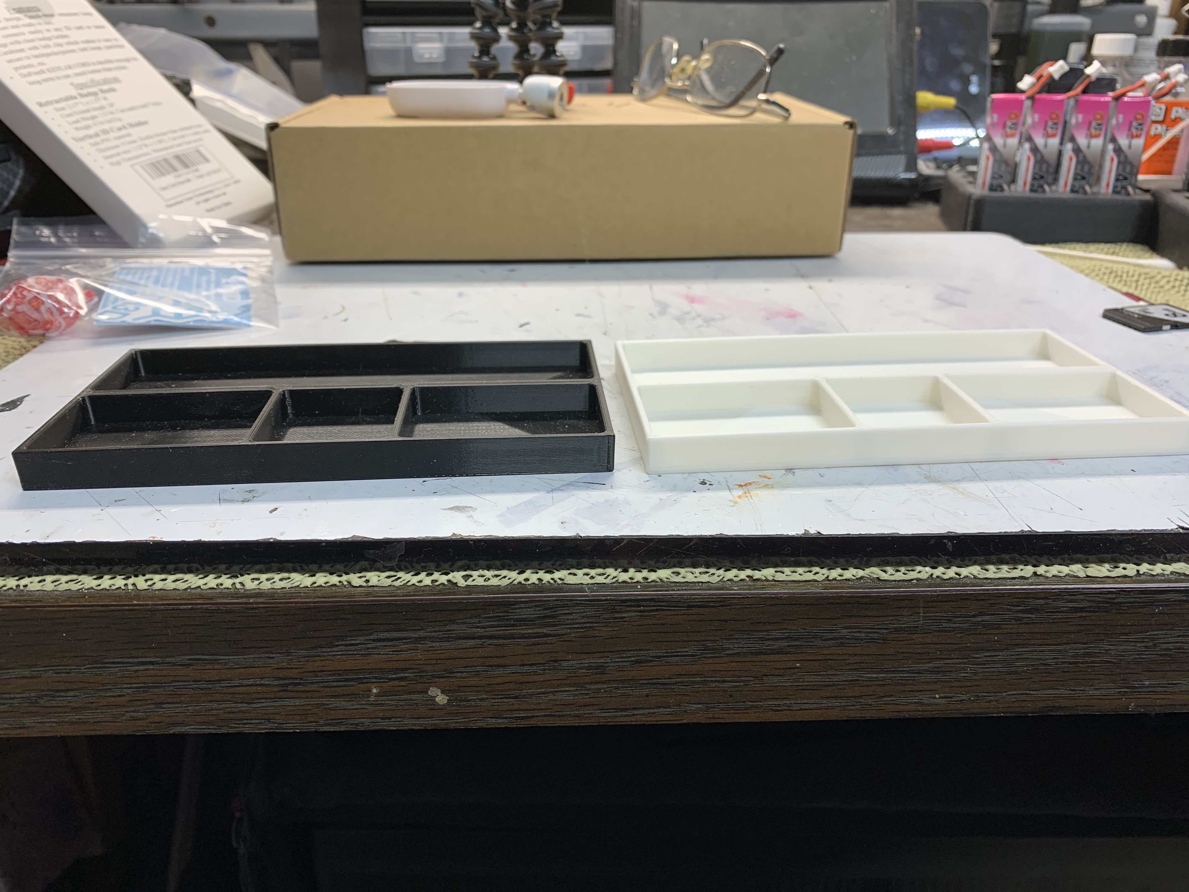

The black one on the left is from the Ender 3 v2 and the white one is from the Sv04. Can’t really see it in the picture but you can see the dividers on the outside on the black on but not on the white. The were both printed from the same gcode file.
They both look very good. Not sure I would have any luck printing something with that large a surface area. Will try some day!
They do look good. @Gramps, what filament and bed surface?
The black one was Hatchbox PLA on the Ender 3 v2 glass bed. The white one was the filament that came with the printer on the magnetic flex bed it came with
Almost certainly, the filament that came with the printer was PLA.
