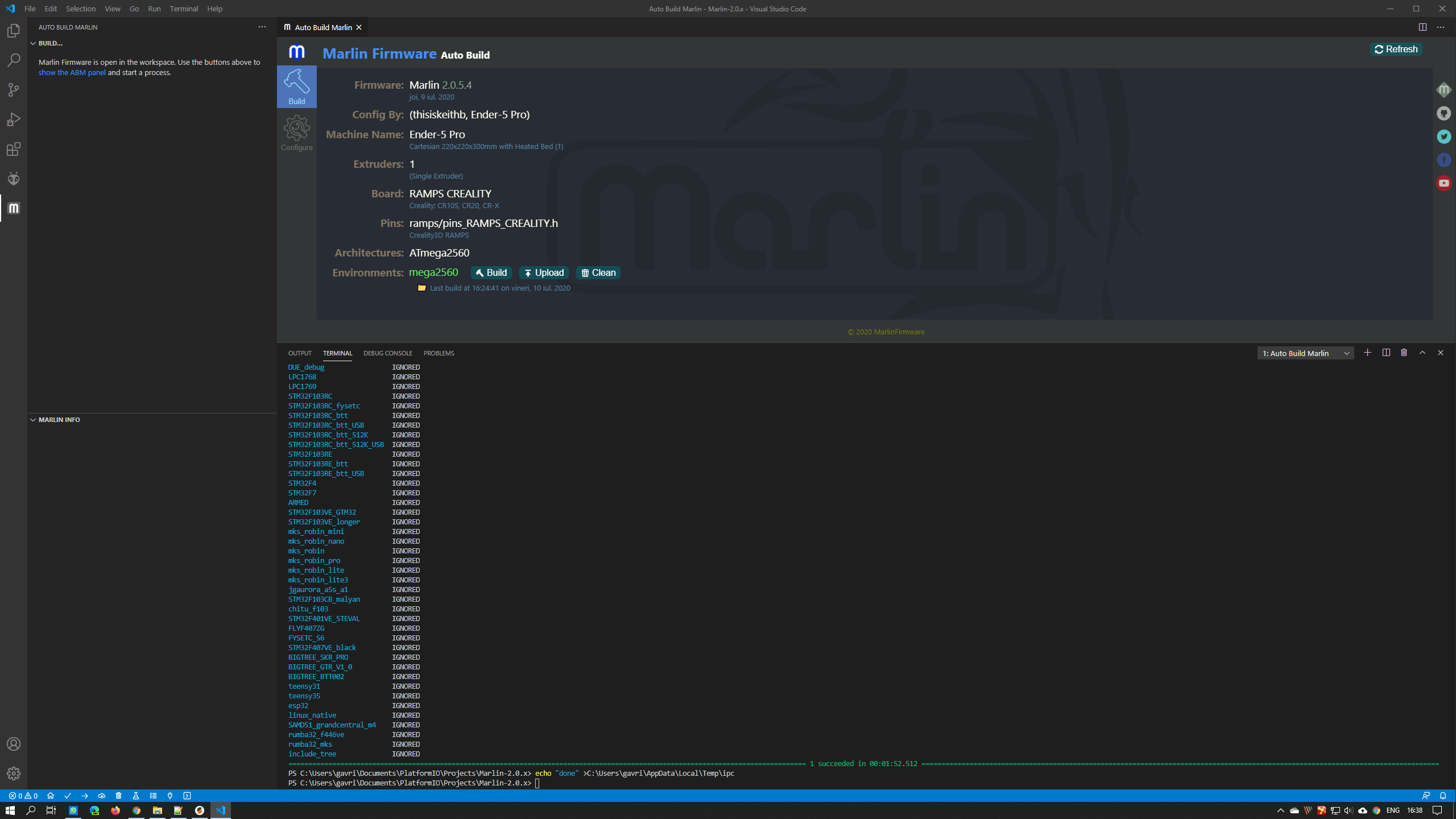

With the help of Mr Doohickey I managed to compile Marlin 2.0 (thanks Mr Doohickey, you always learn from someone). But I still failed to update the firmware.

If you look at the larger version, it clearly shows that the chip is an ATmega1284p, not a 2560. My understanding is that the chip you compile for is vitally important.
I have to look to see where this parameter changes.
#Ender5r Well spotted. My reference was a v2.2 Silent Board which has a 256k CPU. Duh!
#Leo Apologies. I will send you the corrected “platform.ini” and “config.h” files and you recompile the hex.
