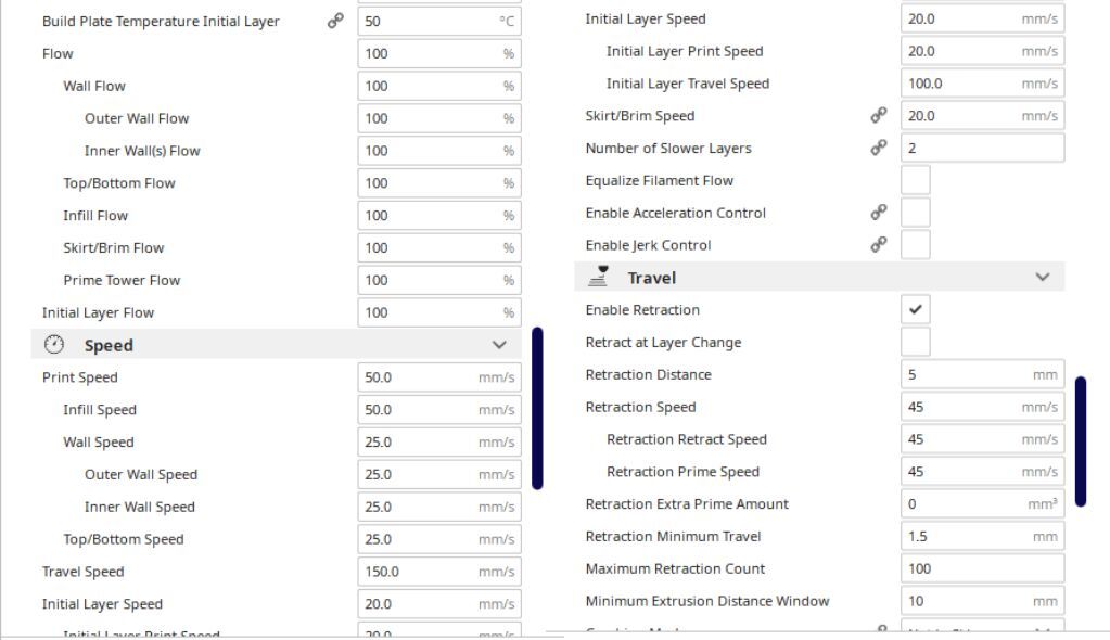

Well I tried the tower test with my .12 profile and it came out great. So I proceeded with printing my actual projects thinking the issues I was having were related to a batch of filament. Wrong. New filament same colors. This time I stopped a print that was having these horrible whisps that was using my .12 and started it again with my .2. No whispy bits and my edge is very clean. I have attached my 2 profiles and the print comparison. This whisps are easy enough to clean but on these sharp edges it’s ruining the print.
I have been advised 2 things to try so far. Change retraction on the .12 to 5mm from 6 which it was at one point and had the same issues. I thought going to 6 would help but sounds like going down instead of up may be the way? And I have also been suggested to change retract speed to 60.
Here are my current profiles.

I did drop down to 5mm retraction. I found at 6 on this new retraction test model I’m using I was getting under extrusion. I’ve been printing all day testing one change at a time and have made zero progress. At least with my test model. Currently with all my tests, 5mm retraction at 55mms retraction speed is where I’ve landed on those 2 settings. That’s were any changes one way or another stopped. Tried lowering my temps down and no change. Currently running now with a reduction in print speed from 65 down to 50 to see if that changes anything. This is really starting to get to me. I wouldn’t mind the whisps if it wasn’t actually ruining the edges of my prints where the whisps are.

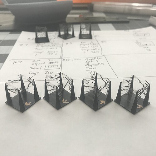

this picture is what I’m dealing with. The one on the far left is best I’ve gotten. It was number 4 out of 8. You can see the first 3 in the background. And really the difference in all of them is very negligible. Kinda why I’m thinking I’m barking up the wrong tree with retraction. I also tried a different slider without any noticeable differences.
Have you tried using Coasting? Coasting replaces the last part of an extrusion path with a travel path, meaning the oozed material is used to print the last piece of the extrusion path to reduce stringing. If it is too high, the printer can under extrude. Good initial settings are:
Coasting Volume: 0.064 (nozzle diameter cubed)
Minimum Volume Before Coasting: 1mm3
Coasting Speed: 90%
Cheers
Haven’t tried that yet. I’ll be giving that a go next.
