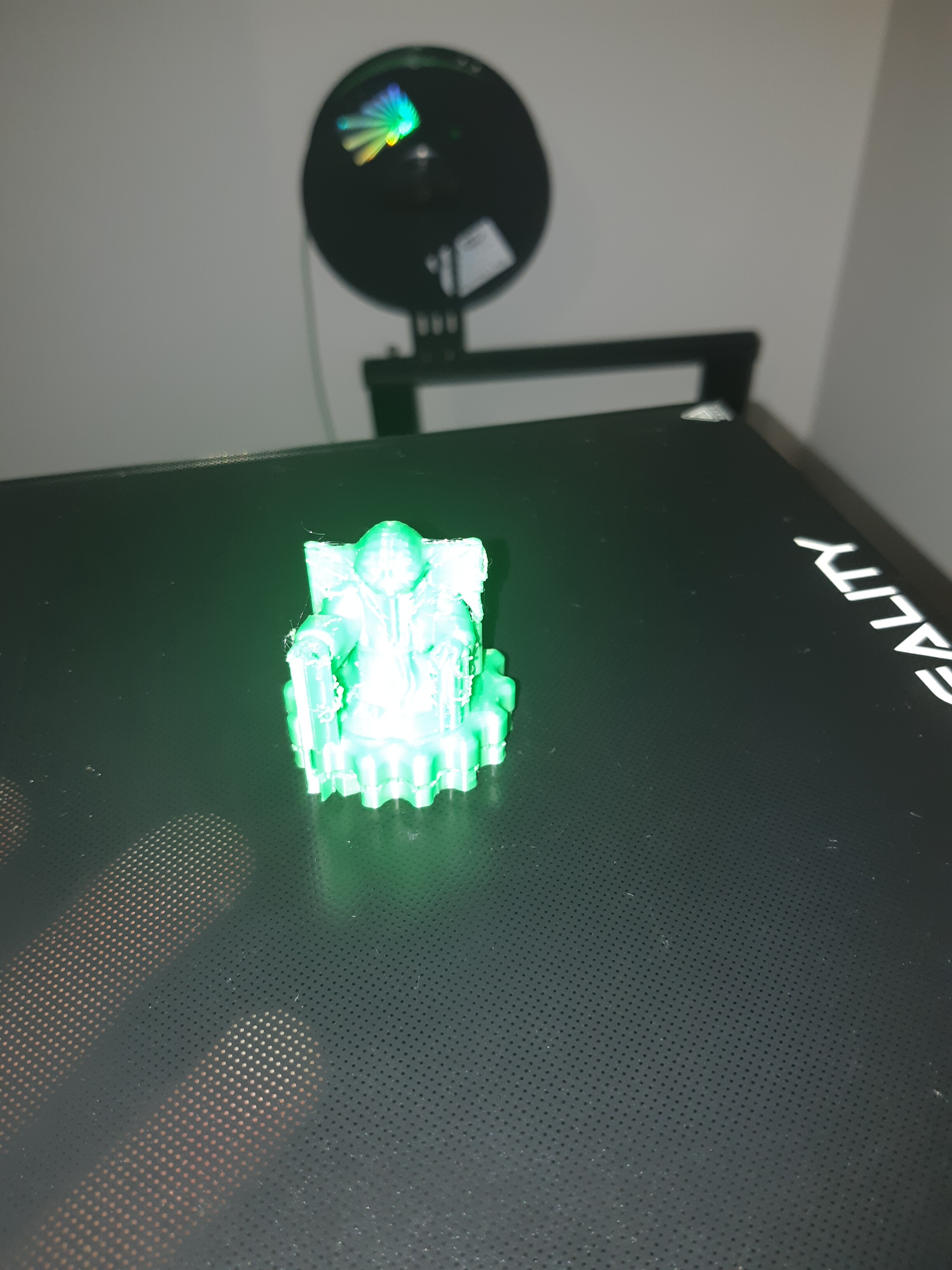

Ender 3 Pro, Green PLA+, 0.4mm Nozzle, 0.12 layer height, 205 Deg C Extrusion, 60 Deg C Bed, 50mm/s speed, 7mm Retraction, 25mm/s restraction speed, Full Support. I cut his cane when removing support.
