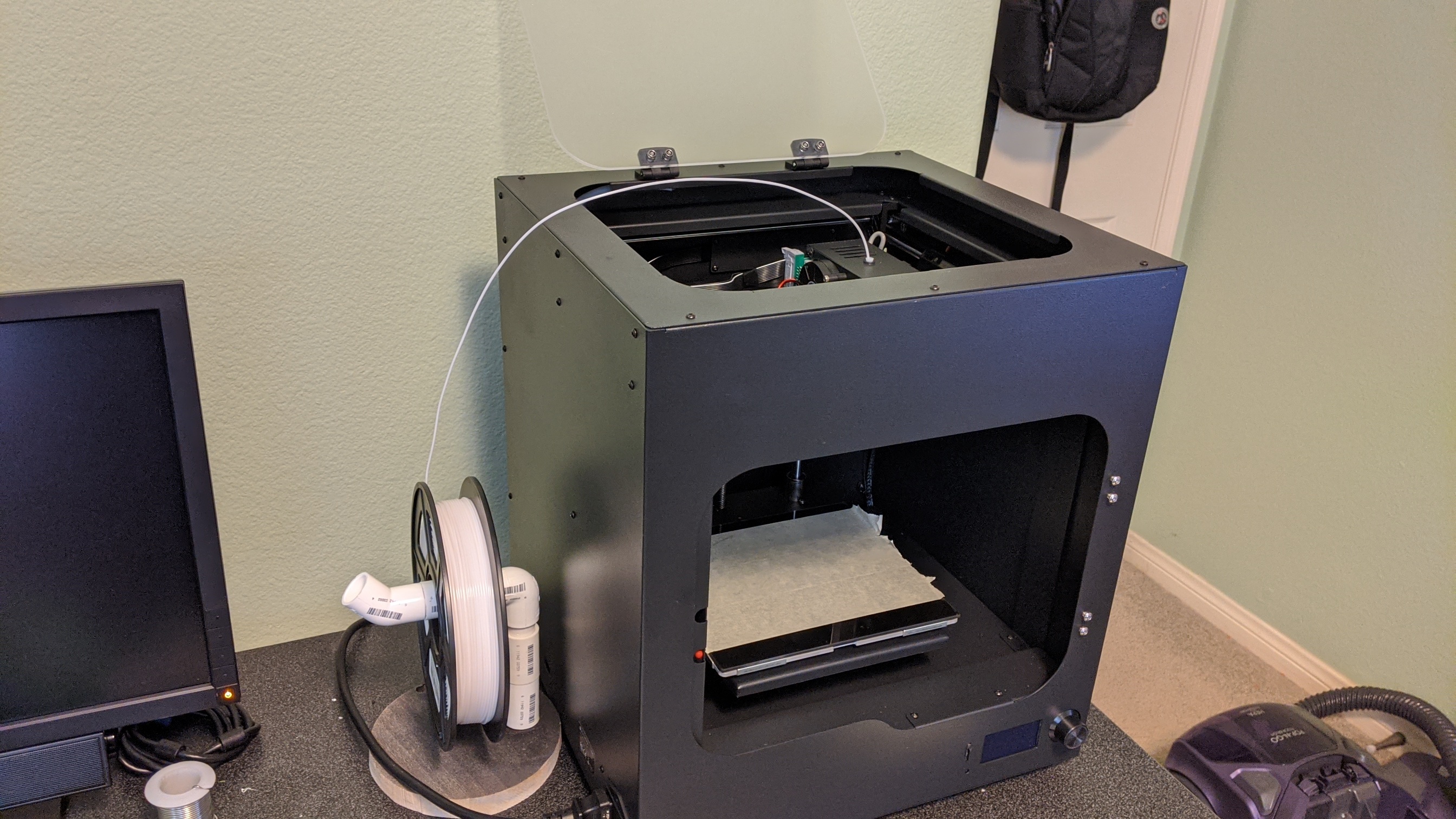

This is my current set up of the Ultimate 2. i got really frustrated with the door when i was trying to remove the packaging foam inside so i removed it. i felt it was too awkward to install the filament inside so i grabbed some spare parts and made my own spool holder. i had to turn off the filament sensor but its ok. it still prints great. @Irv_Shapiro thanks for recommending opening the doors for PLA prints.
