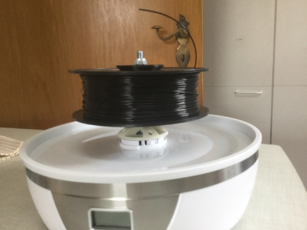

Since I wanted to start printing PETG and flexible filaments, I needed something to keep the filament dry and to get filament dry.
It utilizes my 10mm filament spool holder system, but I included the source file, so everyone can adapt it to his needs.
I basically combined a food dehydrator with a cake tray cover, added a PTFE coupling and some pipe. I also replaced a cover inside the dehydrator and screwed in my own design for better heat distribution and to secure my spool. Done
Have fun!
[ATTACH=JSON]{“alt”:“Click image for larger version Name: FilamentDryer_4.jpg Views: 3 Size: 216.0 KB ID: 3108”,“data-align”:“none”,“data-attachmentid”:“3108”,“data-size”:“full”,“title”:“FilamentDryer_5.jpg”}[/ATTACH]

Sure it would be possible, but it is a lot of work. Especially the enclosure. You also need a fan to distribute the air. Inlet at the bottom, outlet at the top. Programming the stuff, mounting the tech stuff outside, which also needs a case. Stuff piles up, which such a simple project. Of course you could get away with sloppy design, but in the end it will fail you one way or another.
But if you build it fitting your needs, you can do multi filament storage or even a complete heated and well isolated cabinet. I mainly want to be able to print flexible filament and keep the stuff dry. There is no limit. That is the joy of making.
My solution was not only about the pricing, but on the availability and the time needed to build. Beside the designing and printing the spool mount it took me about half a hour to prepare the dome and replace the old cover plate by the new printed one. It actually turned out to be build faster than I was expecting. So I now can process with the real stuff I want to make and not work on basic support.
