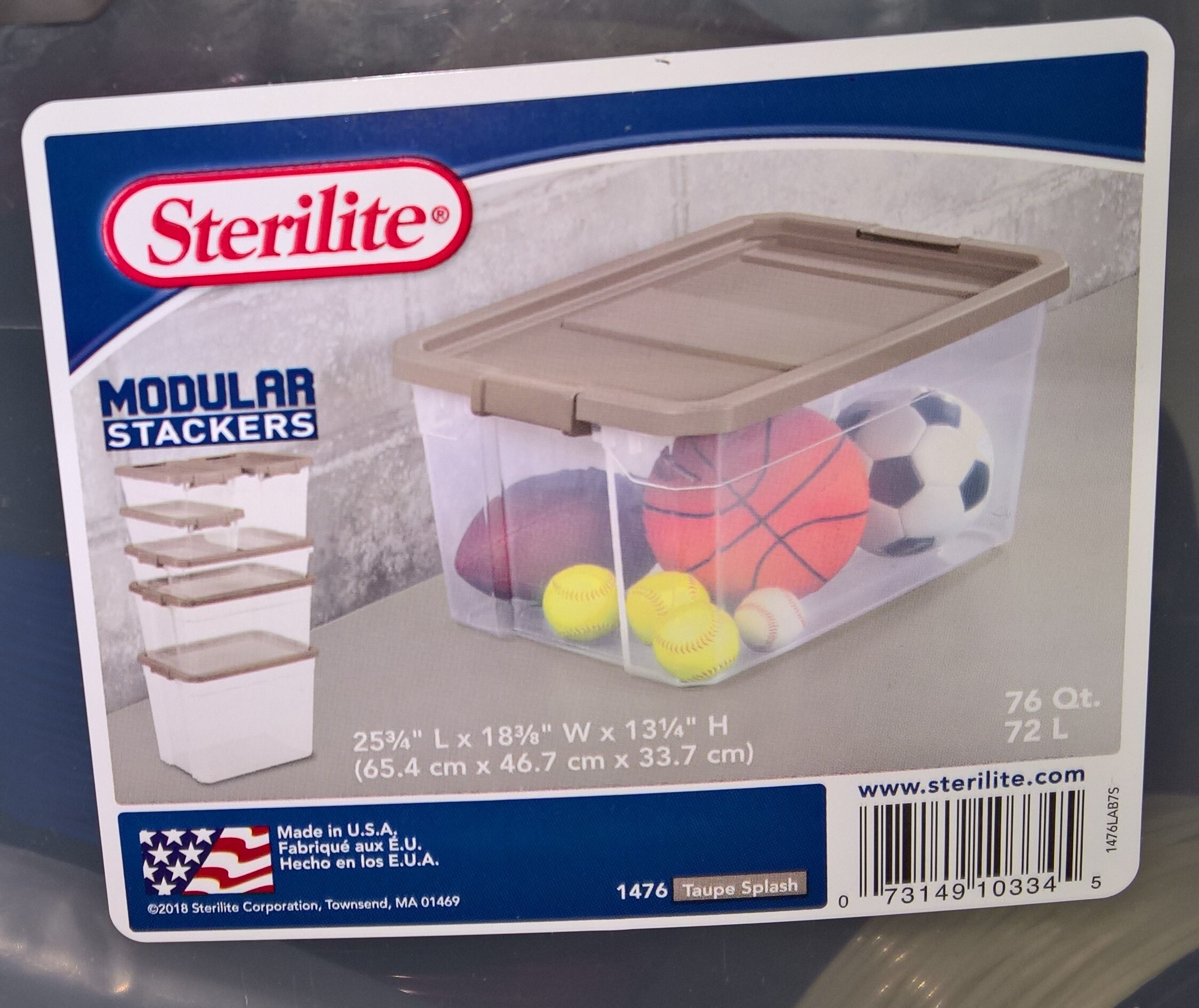

I’m also going to have to come up with a strategy for storing spools. It turns out that the resealable bags the manufacturers ship the filament in don’t really hold vacuum all that well, which is a little disappointing. I also don’t want to spend $20 - $30 on a simple tupperware container. Hmmmm
I purchased some Sterilite clear 76 qt containers that seal fairly well. I just checked they are around $10 each at Walmart. I store all of the desiccant packages that I get with the rolls of filament inside. I attached some pictures - also my dryer - you can also use that to renew your desiccant packs
Tsk tsk Dave, such an untidy mess. What would you mother say? ??? Sorry, couldn’t resist. Besides, compared to my current setup, it’s very tidy.
I’ve been auditing YT videos on using microwave ovens to rejuvenate silica gel packs. One of them said to open the packs and pour the beads into a microwave safe container, but I’m not sure why that’s needed. I’m still researching. It does seem easier than using an oven, and faster than using a dessicator, although I’m sure a dessicator is just fine when time isn’t a concern.
