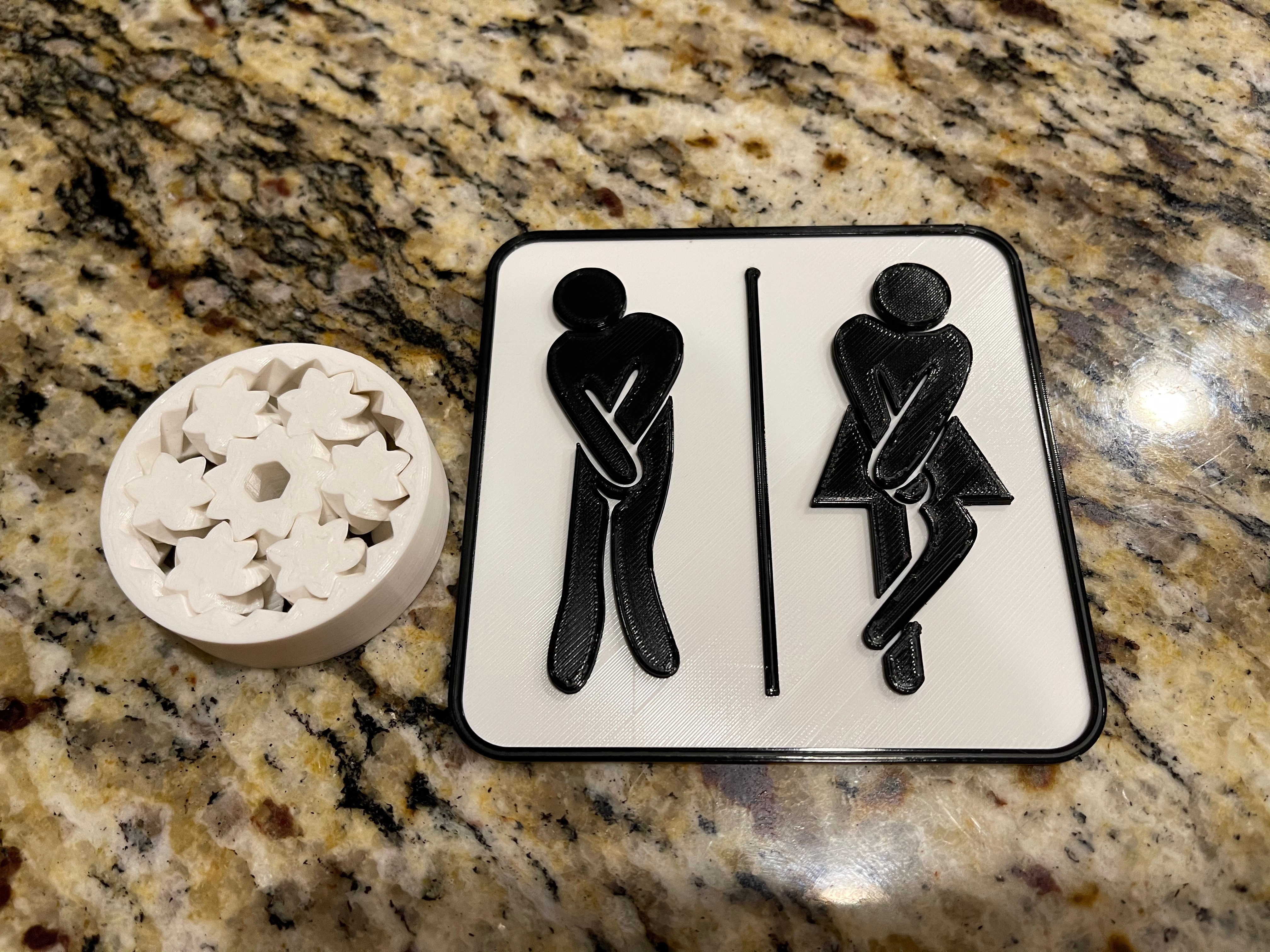

But after I changed filament after the terrible print I think the nozzle finally passed its kidney stone and now I’m back in business. I printed these later today and they came out very good.
[ATTACH=JSON]{“alt”:“Click image for larger version Name: IMG_0275.jpeg Views: 0 Size: 3.53 MB ID: 7090”,“data-align”:“none”,“data-attachmentid”:“7090”,“data-size”:“medium”}[/ATTACH]
