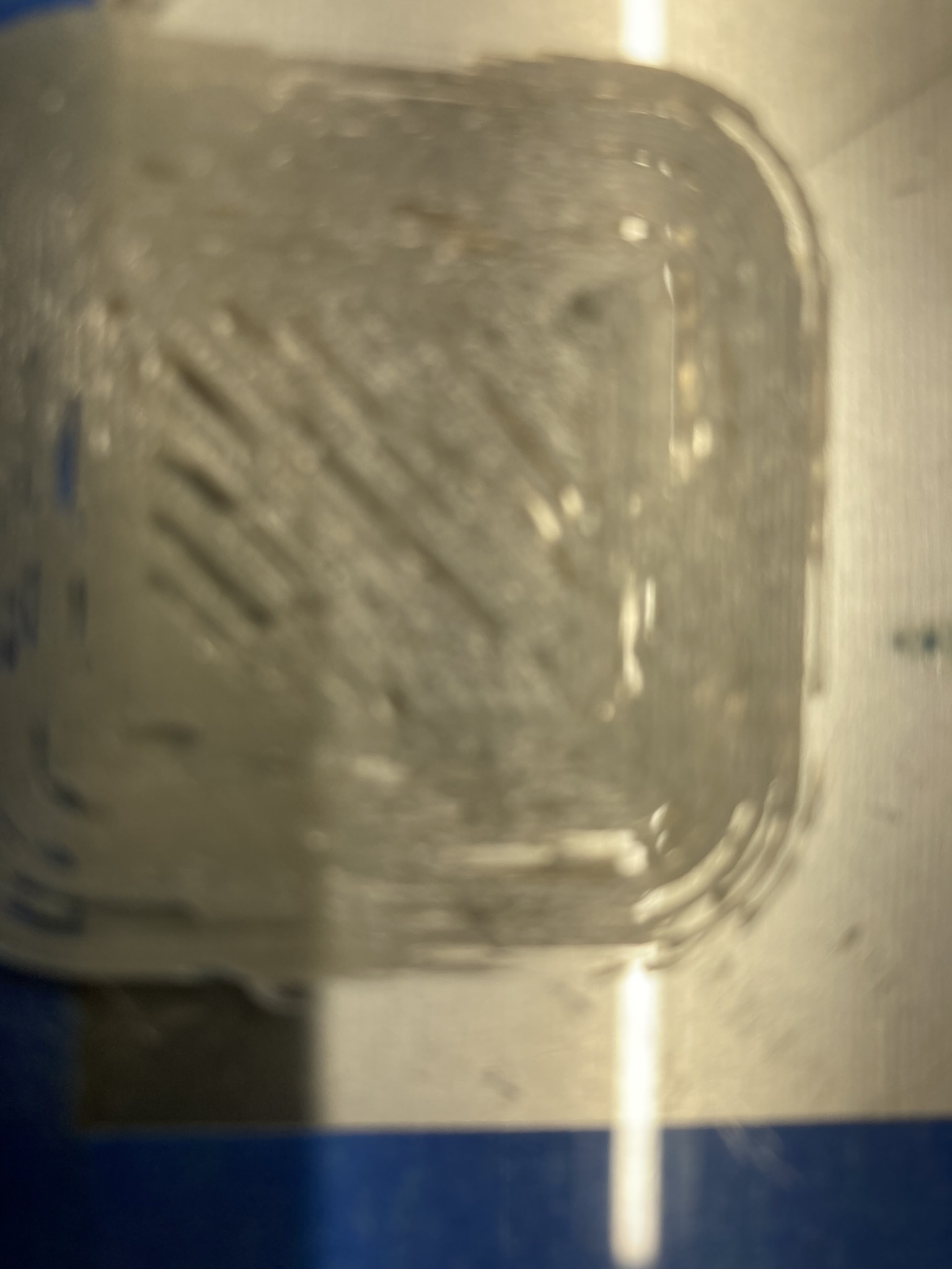

[ATTACH=JSON]{“data-align”:“none”,“data-size”:“medium”,“data-attachmentid”:15657}[/ATTACH] I constantly get bad prints like these. I’m new to 3d printing. I bought a JG Maker Aurora Magic to dabble I. 3D printing. I ended up printing something every day for about 6 months and then I started having problem. I don’t know what to do to fix my prints. I’m using Cura as my slicing program. If some one woul send me the setting that I need change, I would really appreciate it. Right now I just seem to be burning through a lot of filament. Thanks in advance. Enclose is a picture of my last. 3 attempts.
Hi! Which printer do you use? How often do you calibrate the bed level? Is the filament dry? Which filaments do you use, like abrasive ones too? Is the nozzle worn? Do you regularly clean the bed? Are the components still nice and tight? Belts not too loose? No cable folded / bent / broken/ almost disconnected? Is the extroder still OK, meaning no debris inside, no grinded gears? Are the fans still working? Does it have a Boden tube which might be “burnt”? I hope I covered most of it.
Besides what Pigjes said, have you run calibration prints? Also, I have only begun to read it, but many people swear by it, so you might want to look at Ellis’ print tuning guide.
The thing that strikes me most is that you say you were getting good prints, then not. That says to me that something has changed. Have you tried different filament? I assume you have, but just in case. After that, check the printer over thoroughly.
Something else to look at is Hobby Hoarder’s tutorial on first layers. I use his technique all the tie to get my Z Offset just right.
It would help to know more details. What material(s) (and manufacturer) are you printing? At what temperatures? Are you sure that the filament is dry? What have you done to calibrate the printer. A good site for calibrating is https://teachingtechyt.github.io/calibration.html.
My initial guesses would be wet filament or partially clogged hotend.

That could certainly tie into the “top is good, bottom isn’t” scenario. As the filament gets pulled off the spool, drier filament that was buried under the wetter filament will start to get used.

I see a couple of possibles in your photos:
- your nozzle is too high
- you are over extruding
Have you recalibrated your extruder?
Did you follow Hobby Hoarder’s video that I linked to above?

[ATTACH=JSON]{“data-align”:“none”,“data-size”:“medium”,“data-attachmentid”:15687}[/ATTACH] I found out how to calibrate it without a computer and it seemed to work, it was under extruding by a little more than 7 mm. I adjusted it and my next test was a whole lot better. I’m still getting som separation between levels, so that will be my next quest. Thanks for all the help.

I finally did it! Thanks to everyone’s help in the Forum, I got my printer back up and running. It didn’t take much. Just level the bed (about 8 times), replaced the Bowden tube with both fittings, cleaned the filament drive gear, tighten the X axis clogged belt, lube the Z drive screw, …leveled the bed a couple more times…. I want to thank everyone in the forum. Without y’all’s help, I would have pulled out the last 4 hair I have left.
well don’t that look a whole lot better. So, your lesson here is: printer maintenance is actually a thing
Every few dozen hours you need to go over the printer & check all those things you mentioned, plus other.
