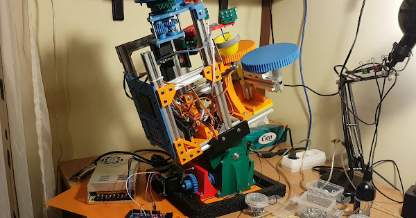

Badminton machine
The first printed version, functional.

But it is not working. Nema17 does not have enough power. :frowning:
Why did you choose a NEMA 17 for this? If you need power/speed, you must choose a DC type of motor such as spindle motor! All of these types are easily controllable from an Arduino with a shield.
It is difficult for me to explain in detail in English.
Simply put, it’s easier to control a stepper right now. But the DC motor is not excluded. I want to try:
  1. weight counter
  2. a better driver for the stepper
  3. nema 23
  4. Probably DC motor with reducer
  5. redesign
I succeeded. With DM556 driver. The minimum amperage can raise is 3.2 A !

The stepper was only for taking a specific angle? I thought it was for throwing off the “ball”
I see where your confusion came from. Yeah, no, he’s had the throwing motor(s) set up since almost the beginning. AFAIK, they simply turn on & stay running until the machine is powered off.
Only tilt.
Turn. :cool:
