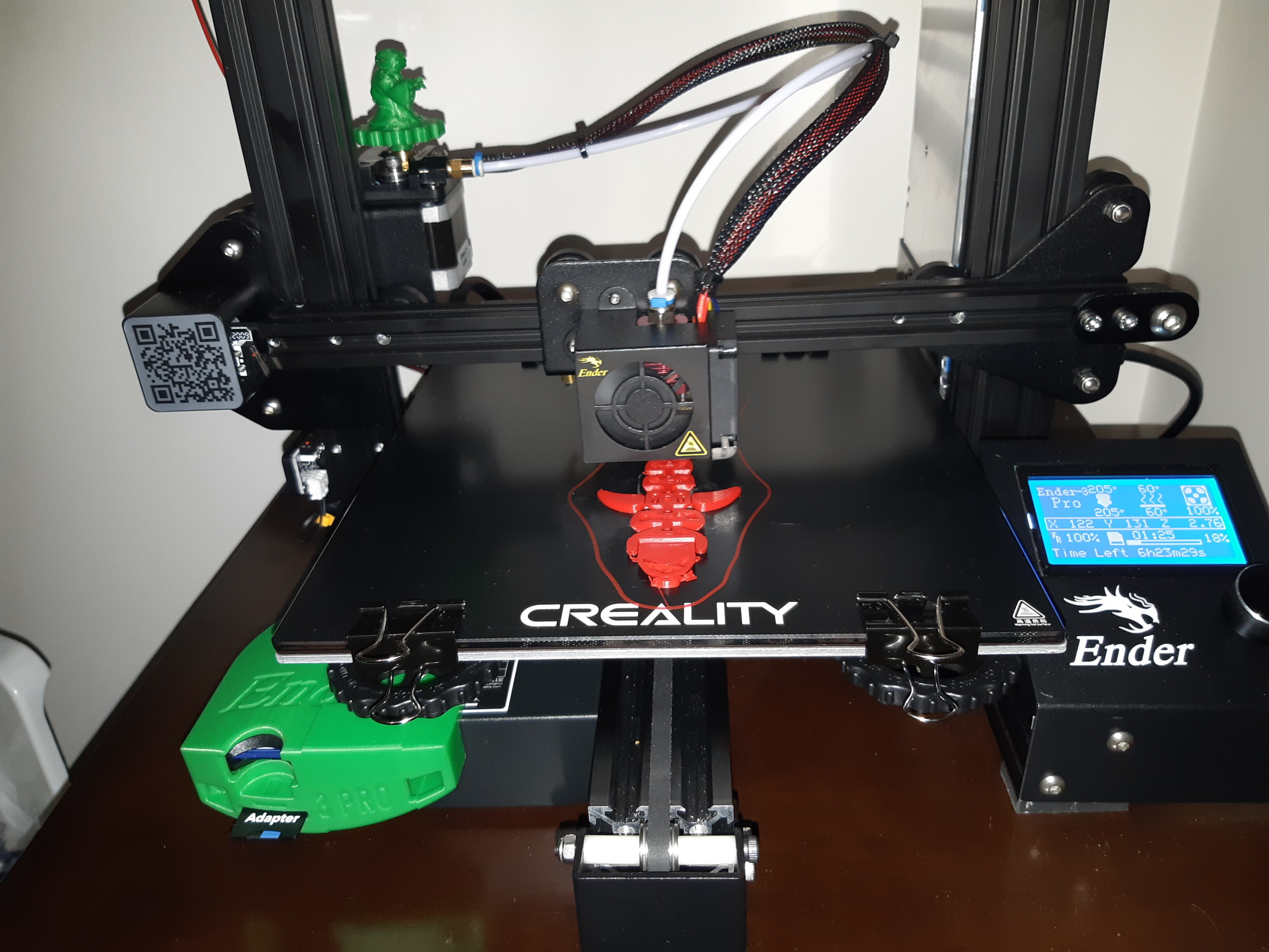

    The kids also wanted a chameleon, which I managed to get a picture of before they took it :slight_smile:
    [ATTACH=JSON]{“data-align”:“none”,“data-size”:“medium”,“data-attachmentid”:648}[/ATTACH]
