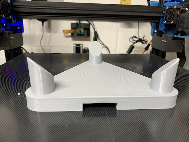

Being happy with the 2nd print I started the print which was the reason I bought some PETG in the first place. My wife has a decorated bowling ball that a friend of hers painted for her, which has since passed. It has rolled off the porch several times. So I decided to make a stand of it. I had already printed it in PLA as a proof of concept. It came out okay but had a couple of issues that the PLA version didn’t have. First the bridging didn’t come out as well as with PLA, there’s 3 slots under it to drain water. Supports would fix that over maybe a little more fan speed on bridging. The second issue is on the top layer(s) looks like it has elephants foot. If had this on the bottom layers but never on the top. It doesn’t take away from the functionality or the looks of the print really. In fact it almost looks like it could have been designed this way.
[ATTACH=JSON]{“data-align”:“none”,“data-size”:“medium”,“data-attachmentid”:14723}[/ATTACH]
That’s a pretty good 1st effort @Gramps. As far as the water drain slots are concerned, rather than trying to bridge that large of a space, I would have designed it as either a triangular opening, or an arch. Given the rather low height, I would probably have done a triangle.
Not sure about the layer expansion at the top. Are you using Cura? If so, check under Walls for Horizontal Expansion – see if any of the several options have non-zero values.

Thanks @Ender5r that’s a good tip on the triangles or arches for the water drain slots. It was sliced in Prusaslicer not sure if it has that option I’ll check. Never really seen that before.
