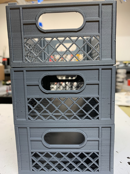

Recently I started noticing these small voids in my prints. I first contributed it to a new filament I was trying. But now I’m seeing them in prints printed with Hatchbox which is my preferred filament. Doesn’t necessary happen in the entire print. The tube in the picture was printed standing up. The white or light colored line is from the lighting and not in the print. I’m using Capacon boden tubing on my Ender 3 v2 and have been for a while now. I did do the mod where there is a 33mm piece of capacon tube in the hotend with a washer on top so the tube in trapped between the nozzle and fitting. I’m thinking a retraction issue but not sure if it’s to much or not enough or speed.

The Capricorn inter tube was replaced maybe a week ago. I use Prusa Slicer using the stock Ender 3 setting for the most part. Haven’t made any changes in the slicer. It’s not really a seam more like skipping. The other thing I’ve done recently was replace the hot end fan. The one has more cfm. Here are 2 other prints where the voids are easier to see and bigger than in the above print. These were printed with Overture PLA, I printed a whole spool of it and didn’t see the voids until towards the end. The new fan was installed before these were printed.

I think the top one was printed 1st on the 2nd one I turned up the temp 3 degrees.
Could be the retract. It seems to print the cross-pattern fine and then, when starting the walls again there is not enough filament at first. It seems during retract the more solid filament gets separated from the fully melted filament inside the nozzle. This is why the beginning, after retract, works for a few millimetre and then the gap is happening. There was air pushed out of the nozzle, which got in during the retract. Until the air is out and the pressure it normalized again, next to no filament leaves the nozzle.

Printed another part for my reel spool, I bumped the temp up 5 degrees to 200 and from what can tell it doesn’t have the voids. I’m printing the last piece now and left the temp at 195 so we’ll see if what it looks like.
The part I increased the heat on printed fine. The last part printed fine too. Think I will scale the crate and printed it using Hatchbox and see what happens
More heat means more flow (ooze) and may also compensate retract issues as the hardened filament cannot disconnect from the molten one, like it did before.

Printed another crate this time I used Hatcbox PLA at 200/195/60 I’m not seeing the same voids that I saw in the other 2. My best guess is that it was a filament & temperature issue.
