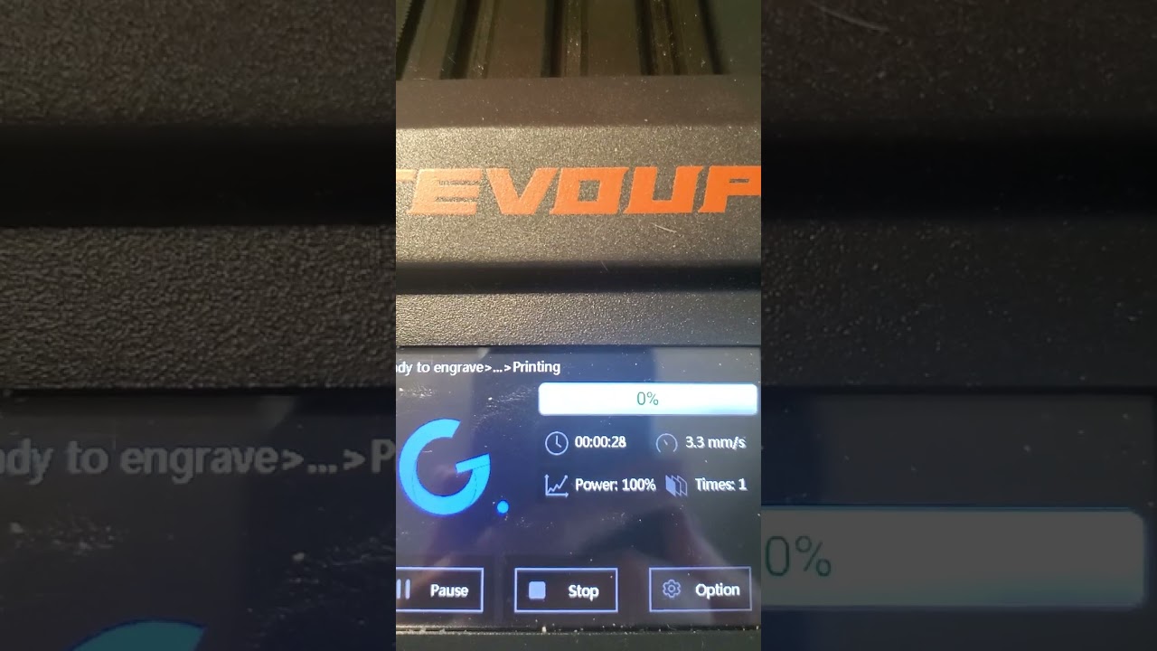

I’ve narrowed it down to the board the the Extruder and Laser module connect to. I tried using the laser this afternoon and it wouldn’t work either. Here are some videos I made this afternoon.
Extruder:
Laser:
