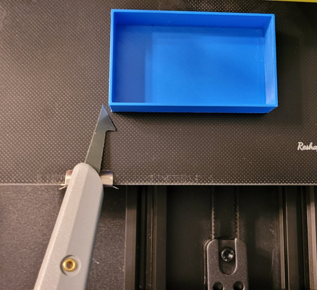

I foldable plastic cutter is my favorite tool to removing prints from glass build plate. When folded, it stores safely in drawer. Prints easily remove when sharp flat part of blade is carefully inserted under corner of print. Prints are always removed after cooling. Exercise safety when using sharp tools! Do not stress build plate.
[ATTACH=JSON]{“data-align”:“none”,“data-size”:“medium”,“data-attachmentid”:15078}[/ATTACH] [ATTACH=JSON]{“data-align”:“none”,“data-size”:“medium”,“data-attachmentid”:15079}[/ATTACH] [ATTACH=JSON]{“data-align”:“none”,“data-size”:“medium”,“data-attachmentid”:15080}[/ATTACH]
Cutter tool is often available at hardware stores, and Hobby Lobby.
