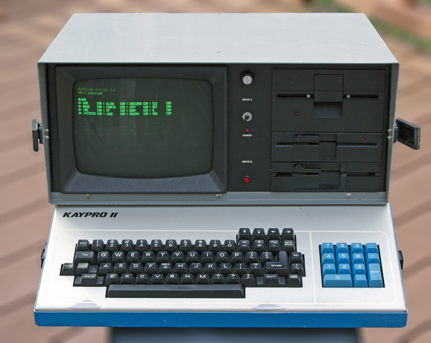

I promised a photo:
[ATTACH=JSON]{āaltā:āClick image for larger version Name: _MG_3608.jpg Views: 2 Size: 891.3 KB ID: 6270ā,ādata-alignā:ānoneā,ādata-attachmentidā:ā6270ā,ādata-sizeā:āmediumā}[/ATTACH] Yep, it booted [SIZE=26px]? ?[/SIZE]
It took a while. I think the arm that moves the read/write heads was stuck. There was spinning sound, but no clik-clik of the heads moving. After about 10 min. of trying, I guess the arm came unstuck and, suddenly, I heard clik-clik and the A> prompt popped up.
Those with keen eyes, and long memories will notice a number of mods:
- green screen, done using a transparent green photo gel. The original is B&W.
- anti-glare screening: a black mesh mounted on the display.
- a speed select switch below the brightness knob (top-center), with a red/green LED below it.
- below the speed switch is a reset button I added.
- the bottom full-height 5 1/4" floppy disk drive has been replaced with 2 half-height 5 1/4" drives.
- you can't see it, but I modded the main board so it can run at 2.5 or 5 MHZ. Yes, I said MegaHertz, not GigaHertz. This thing is from 1981 after all.
Wow. Love the photo. I never kept any of my really old stuff now I wish I did.

Wow! What a nice picture. But it is fairly new technology isnāt it (no 8" floppies)? ![]()
