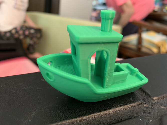

This thing prints amazing, I would have to say these are the best prints I have ever done. Started with the Benchy which is include on the onboard memory, also has an SD card slot but no SD card was included. I printed several poop buckets, yes the Bambu Lab printers poop filament out the back of the machine when they purge the nozzle. I printed several looking for the one I liked after 3 I was finally happy.
