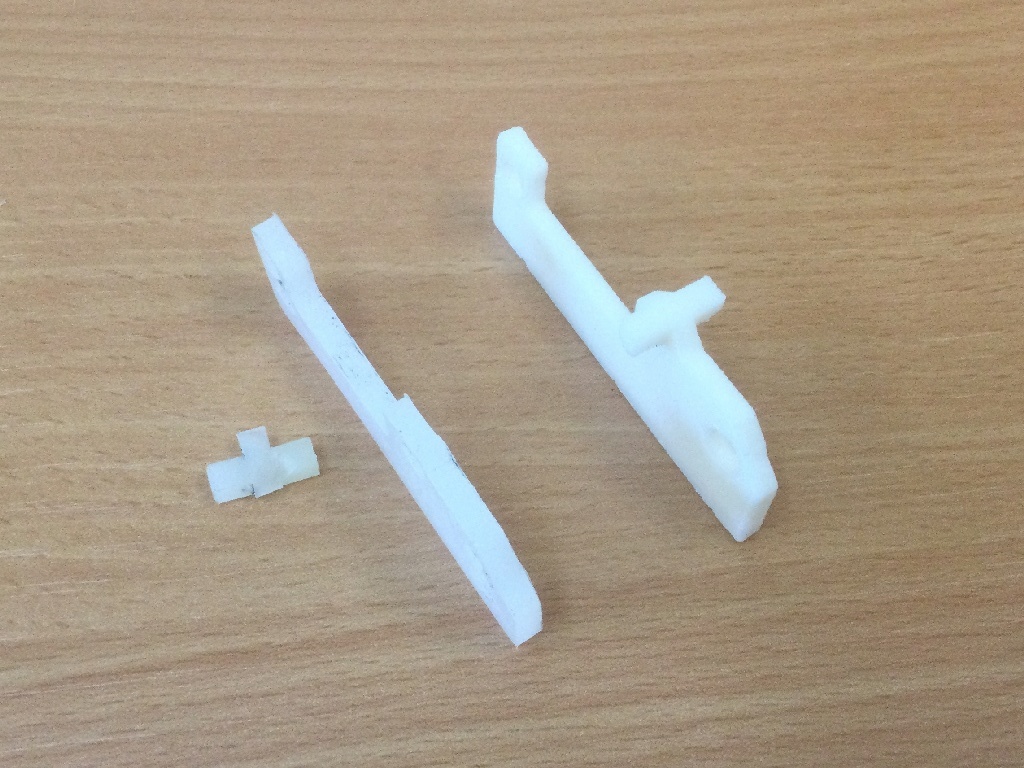

[ATTACH=JSON]{“data-align”:“none”,“data-size”:“medium”,“data-attachmentid”:11050}[/ATTACH]
This is the broken part or a safe door locking mechanism. Why the vendor used a plastic piece for this, is …
I will try to get pictures and the safe model for a thingiverse post, so I will updating the post to share more information on the result.
As you can see the broken section seems to be the weak part.
