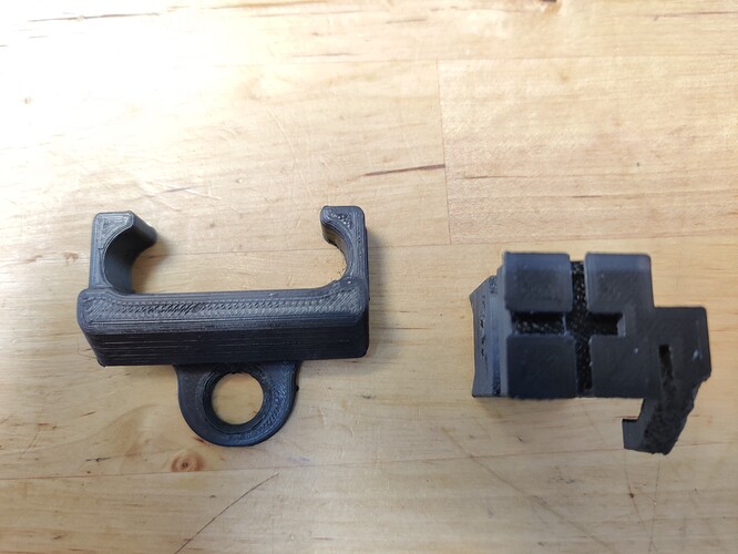

Hi guys me again, can you please look at those pics and suggest how to rectify those problems? Are those a retraction problem? The cat seems ok other then the tail bottom, the other part seams to have more problems. Thanks in advance[ATTACH=JSON]{“data-align”:“none”,“data-size”:“full”,“title”:“IMG_20210509_140409.jpg”,“data-attachmentid”:10109}[/ATTACH]
Those actually look pretty good to me. Not sure what you think is a problem. What kind of filament is it? It looks a bit like carbon fiber.
If you mean f.e. the bottom of the cats tail, then it is clearly a lack of cooling, which makes the overhang sack.
