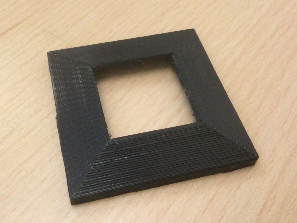

Since Noyes, the company producing my Filaments, decided to drop TPU as people are failing to print and return spools up to 90% of the time, which is bad for a reseller, I had to search for a new brand.
AmazonPrimeDay choose for me, as the Sunlu-TPU was reduced, so I got myself a 500g spool of black TPU.
It was rated a 95A within the Amazon listing, but I do not find any information on the spool or the box about it. My fear was to get some of those extreme flexible and therefore mostly useless materials, but I was lucky. The Filament is a little more soft than my previous Noyes spools, but it prints very well.
All it took was to reduce the temperature, as the Sunlu-TPU wanted 210°C max, while my old filament was rated to 225°C. So I reduced the temperature to 205°C and it worked just out of the box without any issues. Already printed 20 hours creating floor covers for my stairs railing mount, which I redesigned for TPU use in advance.
I know the bottom looks a little rough right now, but I wanted to see the results to be sure the measurements are accurate, so I just used scissors to quickly remove the brim. The underside looks ugly like hell, because I hollowed it out using a sphere to get space for the concrete around the square rod of the hand rail and support and TPU does not work together well. Since I used three walls the first acts as ugly support, which no one sees anyway.
And before you ask: the broken pieces were a quick PLA print I made during the pandemic. They worked fine, if someone would have stepped on them, they would have been destroyed just like the one I broke off on purpose. I only had white TPU, which would have looked bad. Now I have to print the rest of the seven and they will last for the next decades.

I know Sunlu has kind of a bad reputation, but since this is my first spool and the quality is excellent I cannot blame them for anything, even so I hate to order filament my mail instead of just filling up my trunk.
