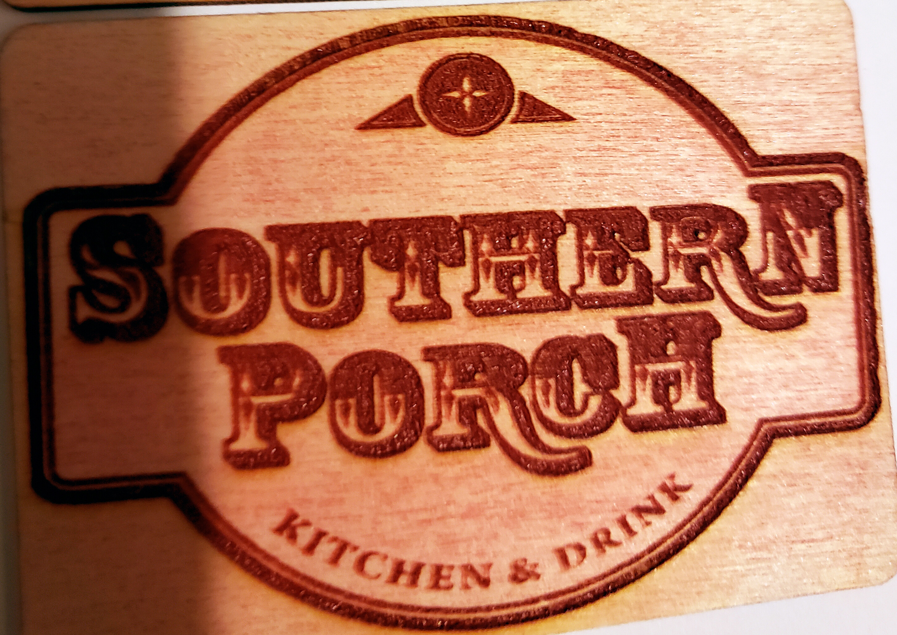

Here are some more pictures of some work I did. I did the Irish Blessing with Green Powder Coating and the Southern Porch that my niece uses for her restaurant in Red Powder Coating. The picture looks more brown than red but actually looking at it, it looks Red. The Red Powder Coating wanted to stick to the basswood where the Green did not. The way the color Powder Coatings work is you do your original etching at the normal parameters and then you sprinkle the powder coatings on the etched basswood and then scrape it off. What is in the indent where you have etched the powder stays. Then you do it over again at a lower power. Then you brush over the basswood and What you See is what you get!
