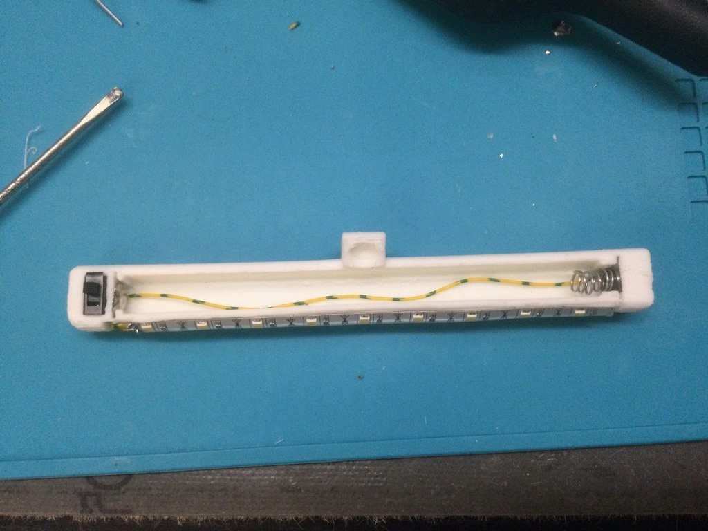

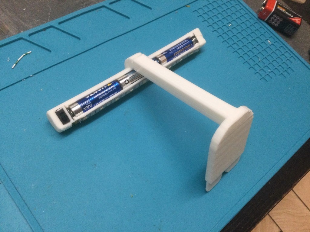

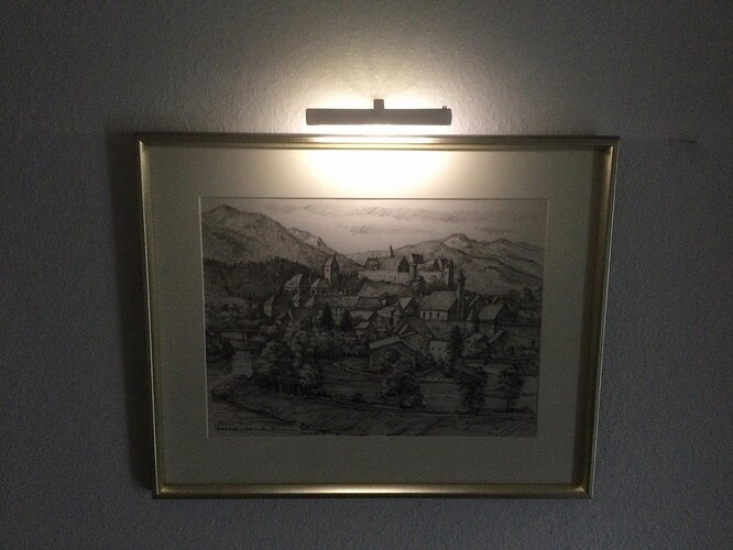

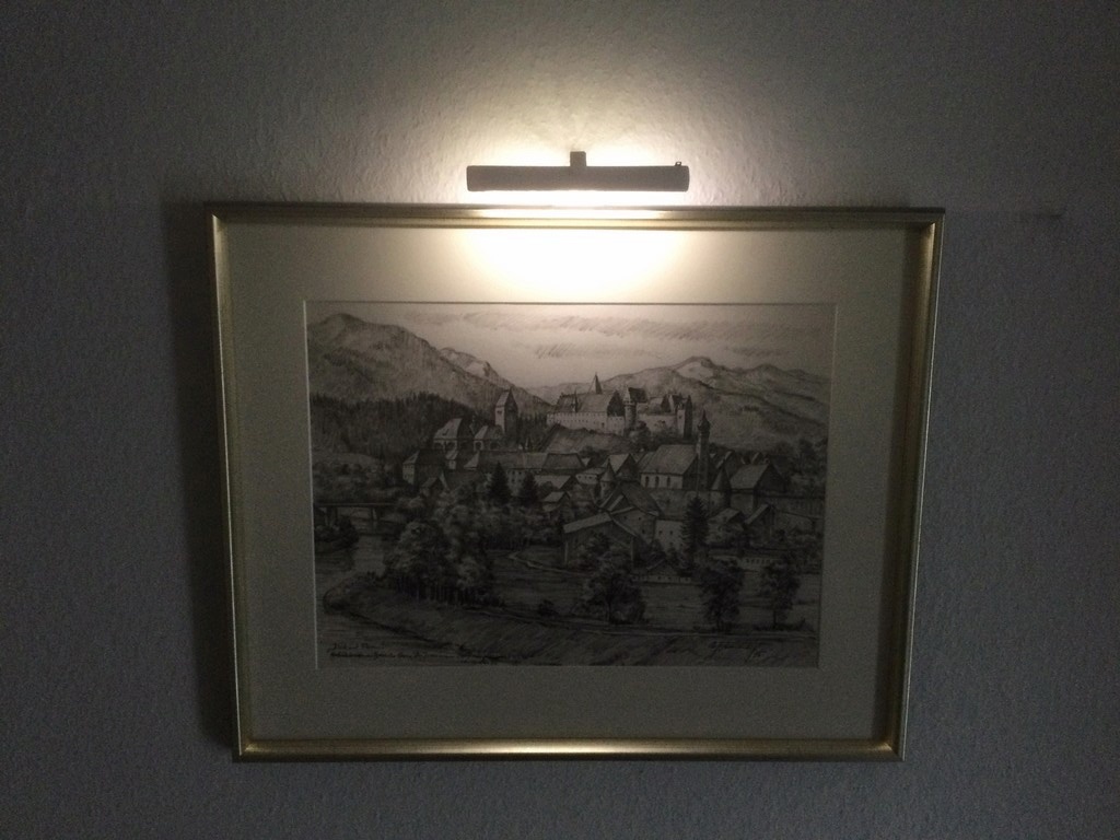

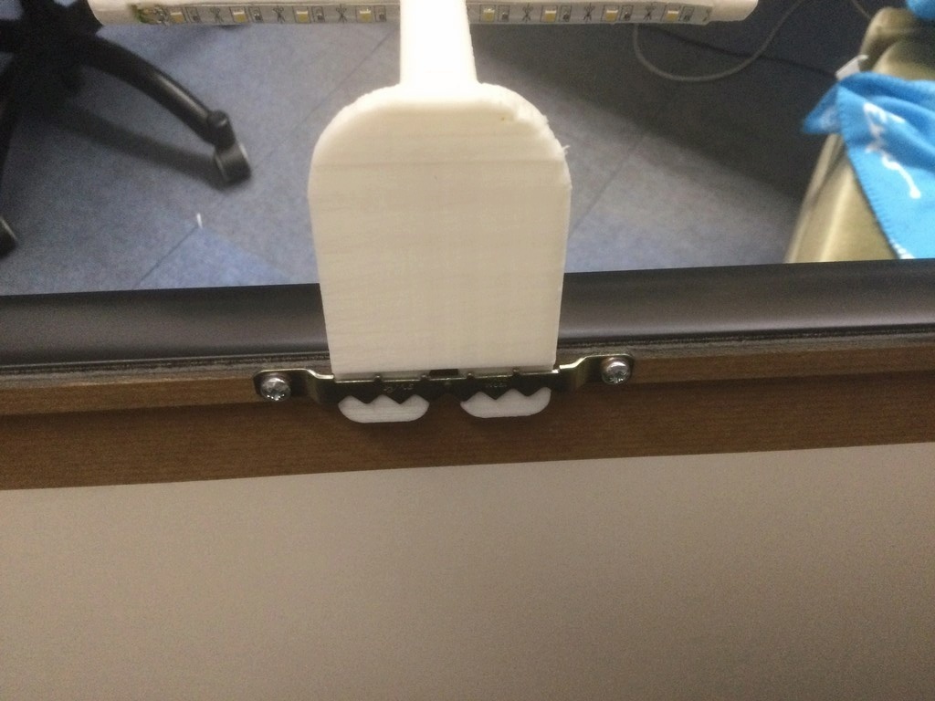

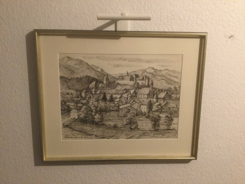

This is a little DIY recycle project for which I gathered some parts from around the house to make something cool.
I saw spots like this in a restaurant and thought I can do that and here is the result. A picture frame spot.
Please note that the light captured camera is far brighter than in reality. In a dark room with just the spot turned on you can see all details in the pictures without getting flashed by the bright LEDs.
[ATTACH=JSON]{“alt”:“Click image for larger version Name: PictureFrameSpot.jpg Views: 2 Size: 199.6 KB ID: 11991”,“data-align”:“none”,“data-attachmentid”:“11991”,“data-size”:“medium”}[/ATTACH] [ATTACH=JSON]{“alt”:“Click image for larger version Name: PictureFrameSpotLit.jpg Views: 1 Size: 180.6 KB ID: 11993”,“data-align”:“none”,“data-attachmentid”:“11993”,“data-size”:“medium”}[/ATTACH] [ATTACH=JSON]{“alt”:“Click image for larger version Name: PictureFrameSpotParts.jpg Views: 1 Size: 205.0 KB ID: 12002”,“data-align”:“none”,“data-attachmentid”:“12002”,“data-size”:“medium”}[/ATTACH] [ATTACH=JSON]{“alt”:“Click image for larger version Name: PictureFrameSpotBatteryWired.jpg Views: 1 Size: 191.5 KB ID: 12003”,“data-align”:“none”,“data-attachmentid”:“12003”,“data-size”:“medium”}[/ATTACH] [ATTACH=JSON]{“alt”:“Click image for larger version Name: PictureFrameSpotComplete.jpg Views: 1 Size: 208.0 KB ID: 12004”,“data-align”:“none”,“data-attachmentid”:“12004”,“data-size”:“medium”}[/ATTACH] [ATTACH=JSON]{“alt”:“Click image for larger version Name: PictureFrameHook_3.jpg Views: 1 Size: 167.7 KB ID: 12005”,“data-align”:“none”,“data-attachmentid”:“12005”,“data-size”:“medium”}[/ATTACH]
More information can be found here: Picture Frame Spot by geit_de - Thingiverse

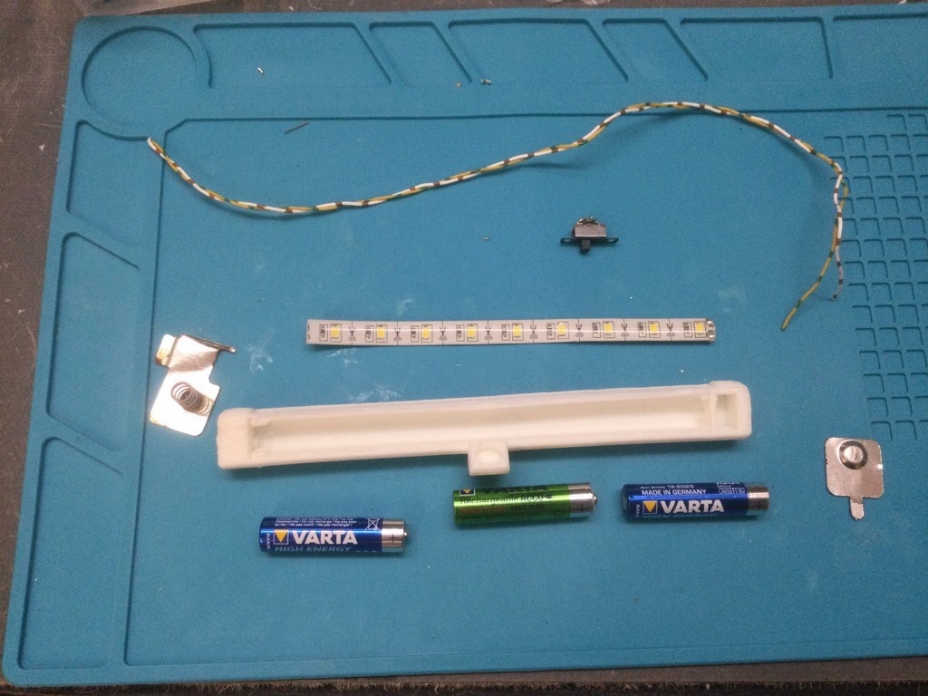

Switch and battery contacts are from an electric long duration LED grave lamp. Replacing the batteries was to expensive compared to buying a new one, which already comes with batteries. Well why throw away when it contains electronic components you may can use in the future? I bought the 30cm 20 LED strip from the dollar/pound/euro store (1,30 Euro) month ago. The USB connector already was used in one of my power cables for my Ring Lights and I usually use the LED strips to bring light into my printers. This one is now lighting two up my picture frames and I have 2 LEDs left to use elsewhere.

Out of curiosity how many hours would that lamp light up properly before it starts to dim?
I did not test that yet. It will only be used when I have guests, so it doesn´t really matter. You can tell from the pictures that I already used batteries which had not enough power anymore in their previous location. So that is recycling, too.
Just from the size and the knowledge that a 2032 battery powers a single LED with flickering chip for several days, I assume chunky 3xAAA batteries will last with the nine LEDs around the same time. Mains power was no option in this case.
I’ve never played with those LED strips. I must get some when I get my present project off the ground.
I would imagine 3xAAA batteries could power the light for many dozens of hours.
