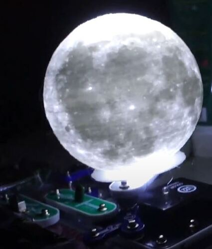

the blue-ish glowing one that ground the 0.6 nozzle in a few hours is the “eSun PLA+ Luminous Blue”, we also use the Extrudr “PETG Glow in the Dark” filament (greenish glow)…the eSun appears to be the more abrasive one…left to right in the attached image with steel nozzles" 0.4, 0.6, 0.6 worn, 0.8. Other image shows the brilliant glow achieved by these filaments…very fun I get to be a kid again & the 4 inch moon lamp printed with the 2nd 0.6 nozzle…My son wants to print a larger version & we will likely go with the 0.4 nozzle to hopefully get better gray-dations despite the much longer print time…

My son would like to print a larger version…I like the detail in the 5 inch version image you posted & we will likely go with the 0.4 nozzle to hopefully get better ‘gray-dations’ despite the much longer print time…I am also thinking of trying to follow his series of Moon Lamp ‘Instructibles’ to learn what I can do with the various available NASA data: https://www.instructables.com/Simplified-NASA-CGI-Moon-Lamp/

Other images show the brilliant glow achieved by these filaments (very fun I get to be a kid again & their color in daylight, the 4 inch moon lamp printed with the 2nd 0.6 nozzle…
I just used the ~250MB version. As it was, it took 15 hours of spinning beachball in FreeCAD to do the 2 mesh operations to merge my mount to the 250 MB 8" moon and 107 hours to print. I hate to imagine using a higher resolution moon.
The 5" moon is a good size. That’s the size of the moon I have on my LED turntable base and it’s just right sitting on my computer desk. It looks like that is the 3" moon you printed with a raft? Turned out great! Just a heads up that it is worth trying to print it without a raft or a brim–at least it worked for me to just use a skirt. I’m using the Ender 3 V2 stock build plate with Magigoo.
