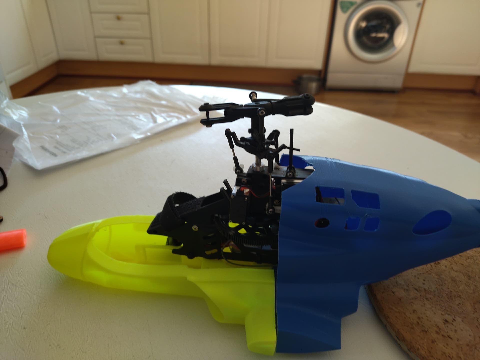

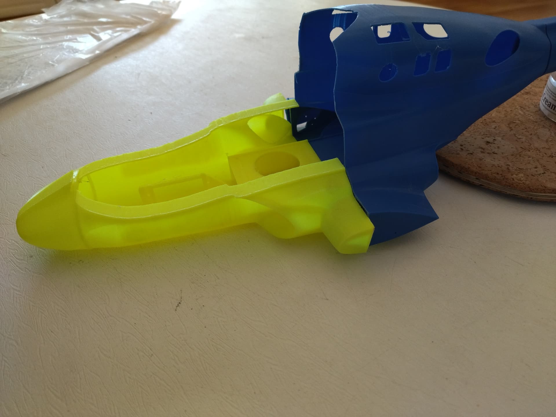

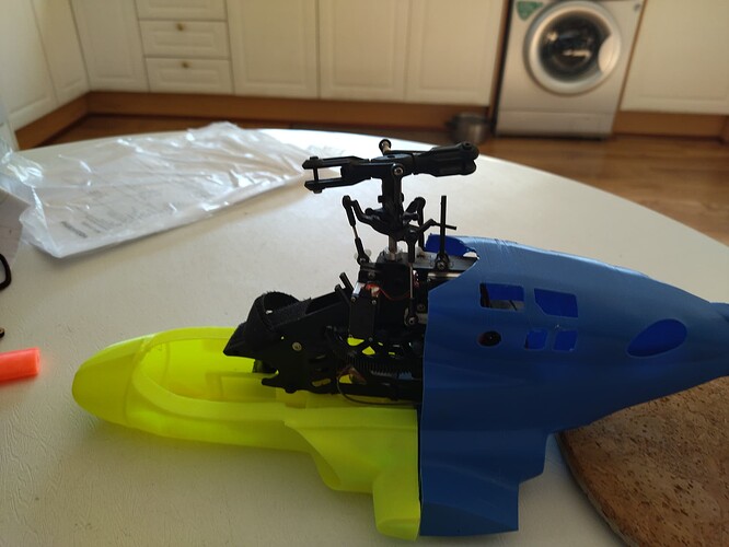

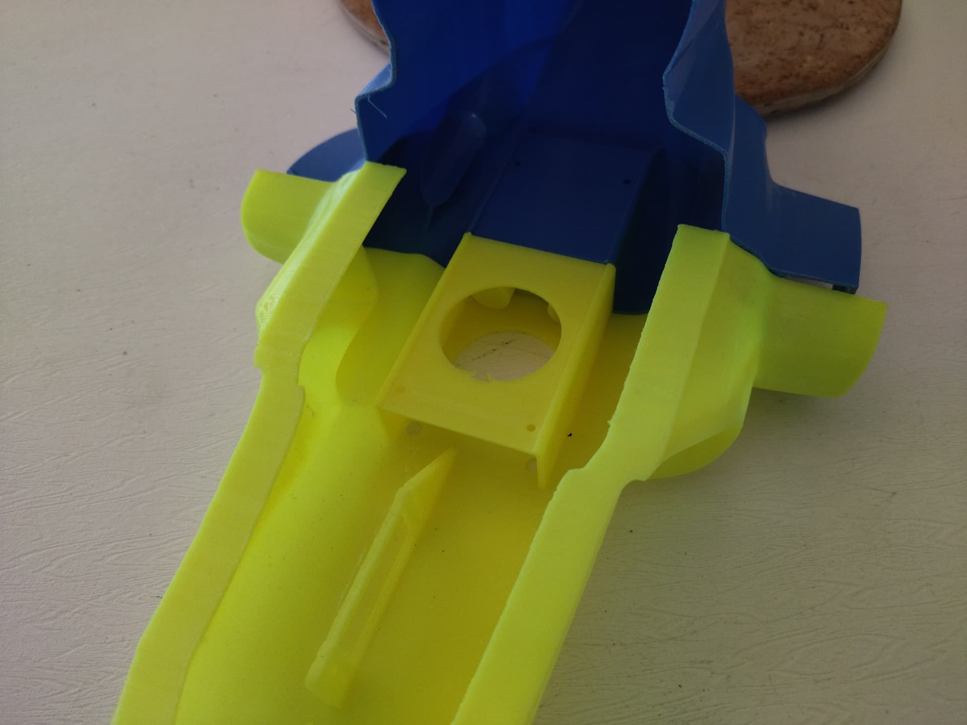

If one looks at the uploaded stl one can see that it is part of a radio control helicopter fuselage.
It incorporates two blocks inside the fuselage. I wish to remove these blocks as with them in my mechanics do not fit.
