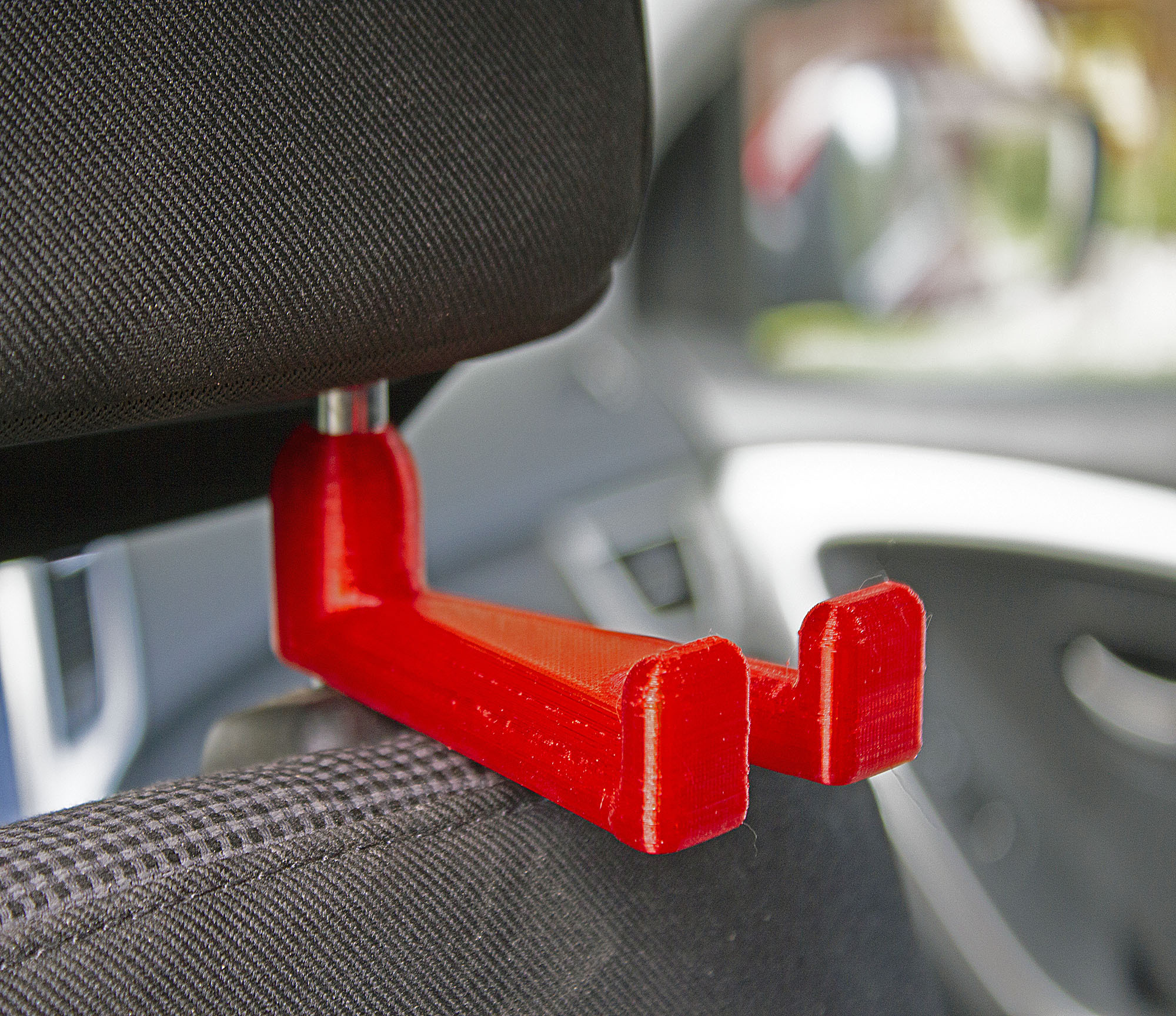

I printed it with Hello 3D Carbon Black PETG. It came out great. It’s as strong a heck, and fits on the headrest post with a beautiful friction grip. It really couldn’t be better that way. However, it did prove to be just a bit shorter than ideal. It’s still very useable, but it would be nicer if it stuck out a little more past the back of the seat. And, my wife mentioned it would be nice to have it in a brighter color.
So, I increased the overall length from 75mm to 100mm. This time I printed it in translucent red PETG:
[ATTACH=JSON]{“alt”:“Click image for larger version Name: _MG_3580.jpg Views: 0 Size: 979.0 KB ID: 4425”,“data-align”:“none”,“data-attachmentid”:“4425”,“data-size”:“custom”,“height”:“206”,“width”:“369”}[/ATTACH]
Again, it is strong as heck (which is a good thing considering how heavy my wife’s purse is). It also fits the headrest post beautifully. BTW, the post is 12.48mm in diameter and I made the hole 13mm in the design. It’s a great combination.

I chose the translucent red for the final version because: first, my wife wanted a bright color and second, because it matches the color of the car.
