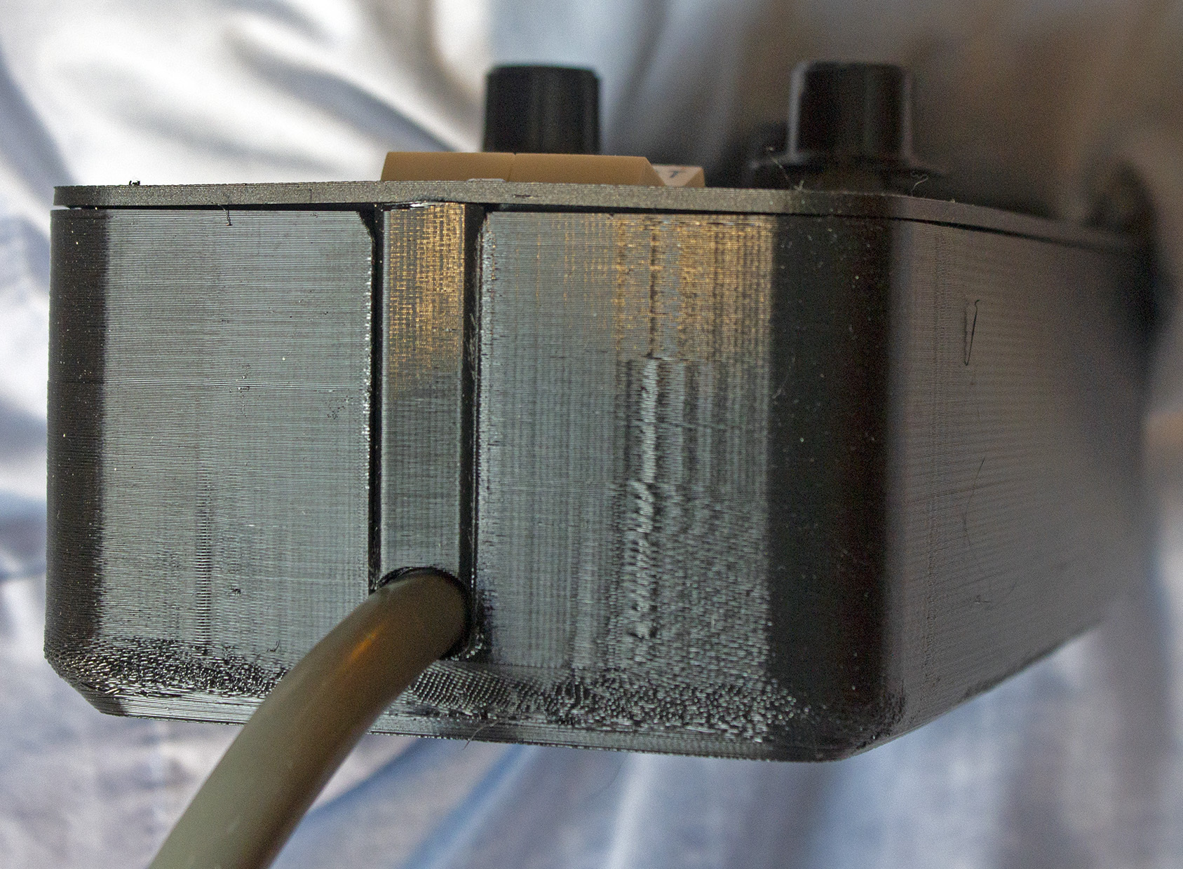

My wife and I inherited 2 massage/tilt beds. We put them together to make a king size. The 1 fault was that the controllers were flimsy. Basically, the plastic was too thin. It led to some of the controls punching through the plastic. The other major flaw is that the cable retainers (you know, those black plastic clamp things that go around the cable and then get squeezed into a hole in a housing) were both gone, leaving the cables hanging loosely through the hole in the housing. Considering the beds run on 120V AC power, I call this unsafe.

It was time to replace the controller boxes. I 1st tried making 1 the same as the original, but it was too long to fit on my printer’s bed, so I had to rethink it. To make it short enough, I decided to design the box so the head and foot massage controls are side by side instead of above each other.
The biggest innovation, at least for me, was deciding to do the lettering as inlay. What I mean is, I wanted the lettering to be done with white PETG filament inlayed into a black PETG faceplate. That way, the lettering would never wear off.
