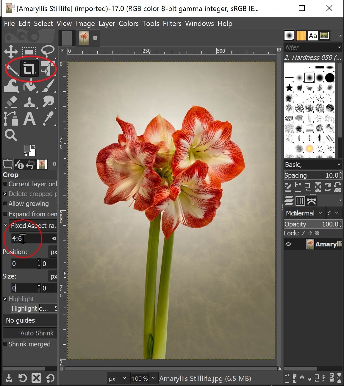

I have another question about the rectangular selection tool. How can I set it to the correct ratio that I am looking for in my lithophanes which seems to be about 100: 150 .
[ATTACH=JSON]{“data-align”:“none”,“data-size”:“medium”,“data-attachmentid”:2951}[/ATTACH]
Please note that the Crop tool is selected at the top left.
